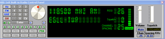

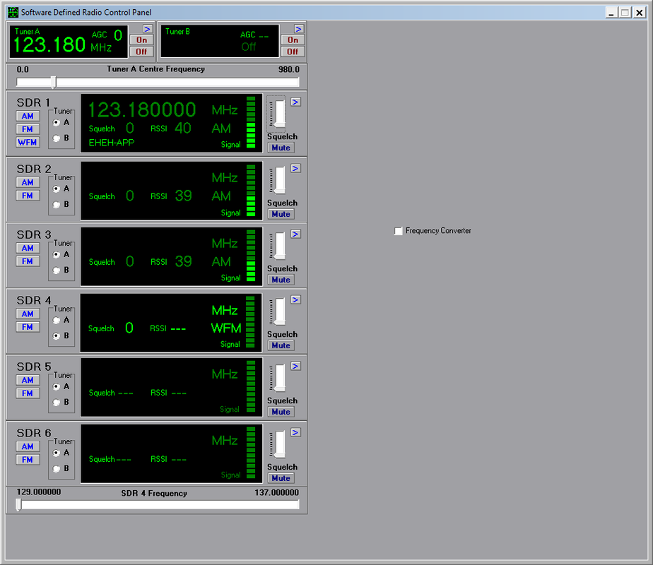

Can someone tell me why my radio control panel is looking like this:
And not like this, as it is in the BaseStationReferenceManual:
As Anmer told me in a PM i just have swap my sbs-1e to the SBS-3 and did not have to re-install basestation.
Do i maybe missing some files in side my c:\kinetic\basestation?

Are you connecting to an SBS receiver or an SDR?
What does the Settings -> Hardware Settings -> Radio tab show?

I'm connected like in your screenshot. I have my SBS-3 with the USB y-splitter cable connected to my pc. And i'm using a roof antenna. As you know sbs-3 has a build-in radio and i have rqf files inside the correct folder (i have created one file for my local airport near by)

I'm not using an SBS-3 so don't have all the radio features available to compare.
But your screenshot appears to be the same as that shown on Page 66 of the BaseStation Reference Manual.
And your second screenshot is on Page 84 and is for the SBS-1eR, not SBS-3.
