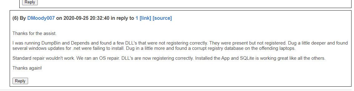

This is an install error with the .Net framework which needs to be corrected, not an easy job. A link I found with the exact same issue is here:- https://sqlite.org/forum/info/2a501c6b828d786e
The end result of the thread being:-
It sounds from that it needs a Win10 repair, which obviously needs to be considered carefully.
Sorry I can't be anymore help with this. I see there have been over a hundred downloads of this, so I guess it is a somewhat rare occurance, but that is not much solice to the person who has the failed install.
