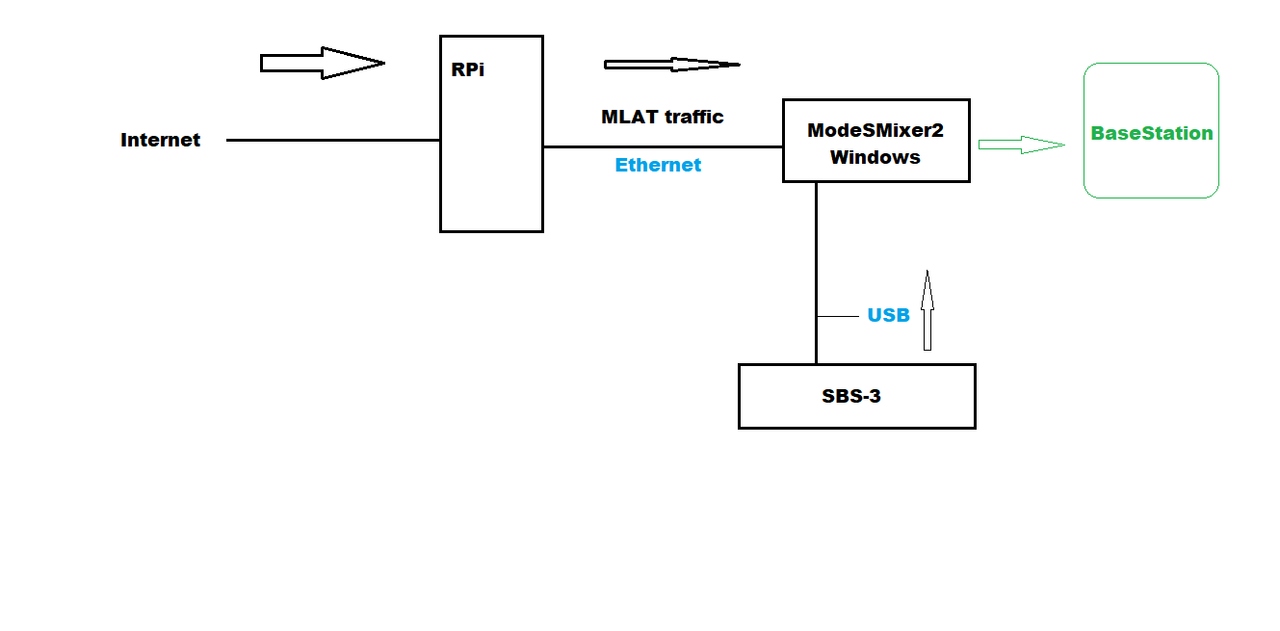

Hello all,
Is it possible to configurate ModesMixer2 that it can feed MLAT data from pi, to ModesMixer2 and then to my Basestation on SBS-3 with USB. Faramir has made a image what i mean. Now when a mill plane or a Police heli is showing with 4 diamonds, but i would like to see it correct location. I know from Faramir that the USB maybe has a default port/ip but what this is we don't know.
I have sent Sergsero a PM but he is not be online here for a long time, so maybe one here can help.
Thanks
SBS-1e & SBS-3 Raspberry Pi 3 & Pi 4
Uniden UBC125XLT

Well here i have to say that BaseStation is getting multi feeds by Faramir, he is connected his air-squitter to BaseStation and also getting data from my SBS-3 true the internet. So BaseStation is possible to get multi sources, i want to keep my sbs-3 connected due to ACARS on it, but would like to use modesmixer2 to feed the mlat data to it.

Faramir
Yes, Basestation can receive data from only one source. The question is whether ModeSMixer2 can connect to the SBS-3 via USB. On Linux, this is no problem as the USB connection uses the ttYUSBx port.
On Windows, the USB 'port' is not that straightforward.
The SBS-3's ACARS and radio options are only accessable via the USB connection so that's why Pipo's keen on connecting the SBS-3 via USB to ModeSMixer2.

The MLAT data that Danny is talking about is backfed from ADSBExchange and FlightAware. This MLAT data is merged into a single BEAST/AVR format using a network only instance of the readsb decoder on the RPi and output on port 30105 on the IP of the Raspberry Pi.
Mike is right, MM2 will not feed into an SBS-3. You need to merge all the feeds together (Pi Output, MLAT output and SBS-3 Output) before passing that to the Basestation software.
I have just logged into your Pi and (hopefully!) set up a modeSmixer2 to output all of your local data combined (including MLAT) on port 10001 on IP of PI. Point your Basestation software at that and see where you get :) (I have used the VRS re-broadcast feed that you send to me to do this - which I believe inlcudes the outputs from the Pi as well as the SBS-3)
R :)
