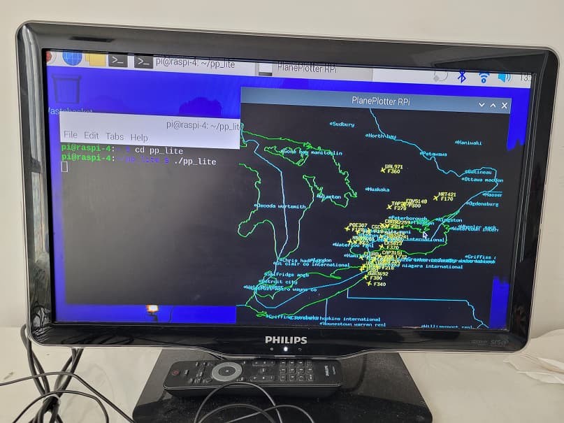

abcd567
Install Plane Plotter Lite (Display) on RPi with Desktop (GUI)
REQUIREMENTS:
1. Raspberry Pi 3B or 4
2. Raspberry PI OS (32-bit or 64-bit) Bullseye or Bookworm with Desktop (GUI)
3. A decoder such as dump1090-fa OR readsb OR dump1090-mutability OR ModeSDeco2 installed on RPi
4. A Dongle and Antenna for the decoder
5. A monitor connected to RPi to RUN PP_Lite from RPi GUI's terminal & view PP Map
6. OPTIONAL: VNC to view PP Map on Windows or Mac PC
Download instructions to install & run:
https://www.coaa.co.uk/PP-Lite-installation-and-use.pdf
Forum for Discussion & help
https://planeplotter.groups.io/g/main/message/131333
Message by Bev, the creator of "Plane Plotter Lite for RPi".
