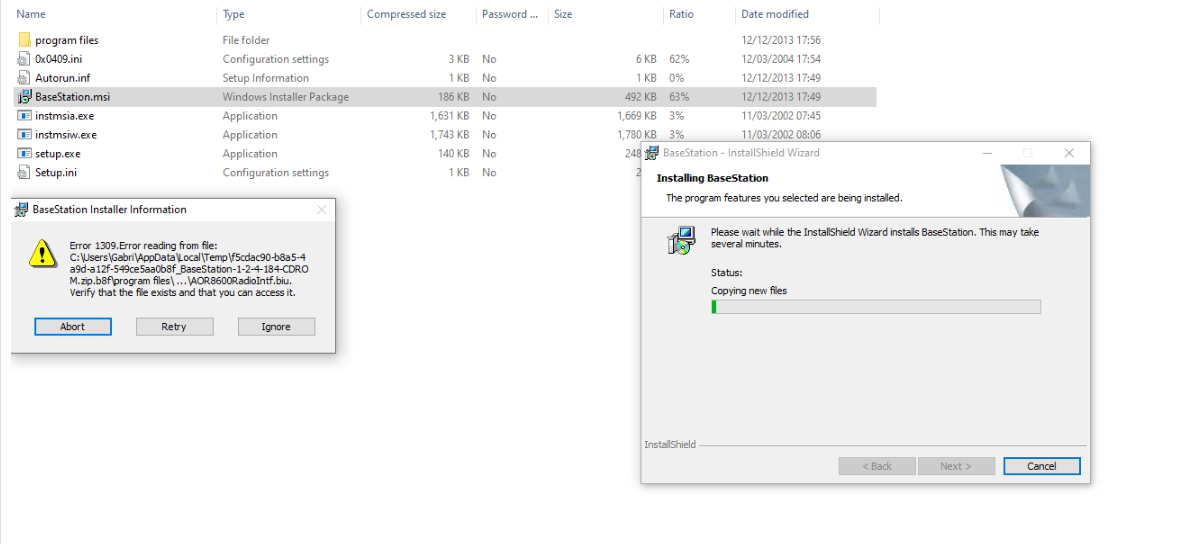

After sitting in a draw for about 5 years I decided to resurrect my 20 year old SBS 1e-. It was running on a Linx tablet which has now met its maker and the instillation CD has also gone AWOL. not to be defeated I went to the kinetic site to download from there but instantly came up against this error. Searhing the internet for a second hand disk I came across a thread in this forum regarding a google download, of course now Ive joined I cant find the  thread. Does anybody have any ideas of the way forward to get the box working again. I feel this may be a long process so hope you are all patient.
Welcome back  :)
Unfortunately your images can't be accessed, the link takes me to a image hosting site and invites me to buy a subscription.
All the BaseStation files are in our Software section.  I suggest you download the BaseStation 184 CD file and do a fresh install.
Please post back here if you need further help.
