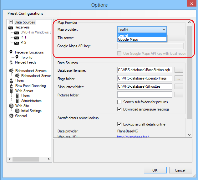

I dont want to give Google my Credit card number, even if their invoice is zero.
VRS now provides both options: Leaflet/OpenStreet and Google. It is up to user to choose which one he/she wants.

Quote from: abcd567 on October 10, 2018, 12:28:18 AM
Same here, I dont want them having a credit card nor a bill.  It would be very easy for them to start charging
for even 0 bytes transferred.
We need the option.  Other wise it gets un-installed.
