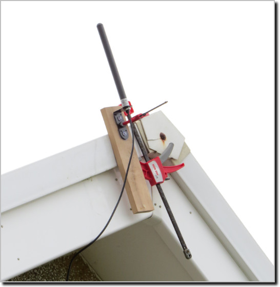

This short, light weight antenna is supplied with a bracket and two plastic suckers for attaching to a window, or, in my case, the uPVC facia board.  Unfortunately, the property is about 30 years old, maybe more, and the facia is slightly pitted.  Although the bracket does attach to the uPVC, it can detach itself if it's windy.
As soon as I set it up, I noticed a massive increase in range compared to the SBS-3 magmount sitting on a pizza tray in the loft. The external is about 4 feet higher than the magmount.
To avoid climbing the ladder to reattach the antenna if it's been windy, I grabbed some clamps and a piece of wood to make a more permanent installation.  It may look fragile, but it's survived the recent high winds, partly due to the light-weight antenna and bracket.

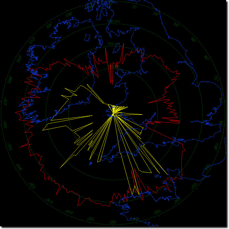

Today I moved the antenna up towards the ridge to see if the extra height made any difference. It did, but not much.
My current location is near Haverfordwest, just south of the Preseli Hills in Wales, the highest point being 1,759 feet above sea level.  The polar diagrams show the effect of these to the north and the Brecons to the east, from approx 310 through to 100 degrees.  To my south and west the coast is about 15 miles away and this is where I'm getting my best range.

I've attached some images of the antenna mount and two polar diagrams.
The first compares the loft magmount in yellow and the external in red.  Quite a difference.
The second has a new plot with the antenna moved slightly higher (yellow) compared to the original location in red.  Some improvement to the east but not too much.
Overall, I'm really impressed with the performance.  It clearly shows the difference that an external antenna can make, even without an expensive pole.  Location, location as they say.  The roof tiles may be blocking data to the magmount but I was getting some plots at 200nm.  Outside and higher is making a big difference.  Unfortunately I have no idea if the external antenna has a better spec than the magmount.
The TMRF-ADSB Mk2 is supplied with 5 metres of low loss, 6mm cable which I could easily feed through an airbrick in the loft which you can see in one of the photos.
