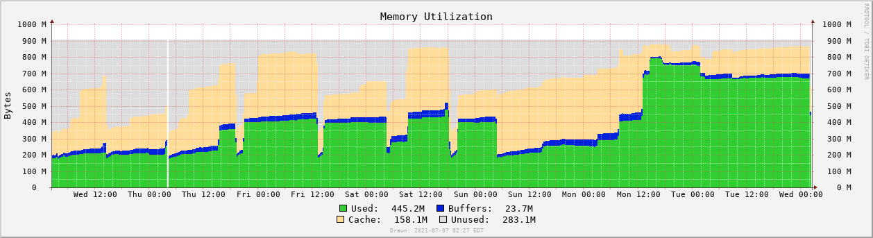

PROBLEM:
The 64-bit ModeSMixer2  (modesmixer2_aarch64_rpi4_Raspberry_Pi_OS_20210228) causes memory usage to shoot up too high.
Given below is 7-Days graph of memory usage on RPi Model 4 with 64-bit Raspberry PI OS and modesmixer2_aarch64_rpi4_Raspberry_Pi_OS_20210228
ANALYSIS:
Checked by following commands:
htop
df -h
Found modesmixer2 is using 78% memory.
Rebooting Pi brought down the memory usage to 3% but after running for few hours, it shot up again to over 70%.
REMEDY:
Replaced 64-bit ModeSMixer2 (modesmixer2_aarch64_rpi4_Raspberry_Pi_OS_20210228) by 32-bit ModeSMixer2 (modesmixer2_rpi4_deb10_20190413)
When tried to run 32-bit version on 64-bit Raspberry Pi OS, got following error message:
error while loading shared libraries: libssl.so.1.1:
cannot open shared object file: No such file or directory
Solved by following command:
sudo apt-get install openssl:armhf
Will watch for next 24 hrs and see how memory usage behaves now.
s92driver
Quote from: abcd567 on July 09, 2021, 12:28:36 AM
Keeping a close eye on this, as I do find I need to reboot the Pi after a while as things grind to a halt.
Steve
abcd567
Watched for 24 hrs, the32-bit version running on 64-bit Raspberry Pi OS / RPi Model 4.
Couple of hours after reboot, the Memory usage of modesmixer2 again jumped up from 3% to 28%
The 28% Memory usage jump by 32-bit version of modesmixer2 is still better than 78% memory usage jump of 64-bit version of modesmixer2.
Since even after excessive memory usage of modesmixer2, the total memory usage of RPi Model 4 with both 32-bit & 64-bit mm2 still remained within the RAM capacity of RPi Model 4, nothing came to a halt in my case.
